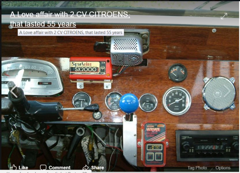

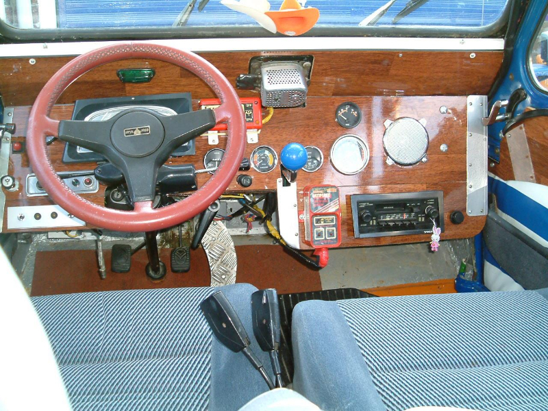

Hello Mel and Jeanette..... I have read your story with great interest... :D your decision to fit an electronic ignition.... will be the best thing you have ever fitted.. especially on Cold morning Starts. :pot:
I fitted an after market Points assisted Electronic ignition on my old faithful ,in 1966 thats been running worldwide for over fifty years..... the same unit.... now days there more advanced.. and more cash, mine originally cost under Five pounds sterling in 1966
I have a secondary unit a different make as a back up on my dash panel...... see pictures enclosed. :enchante:
