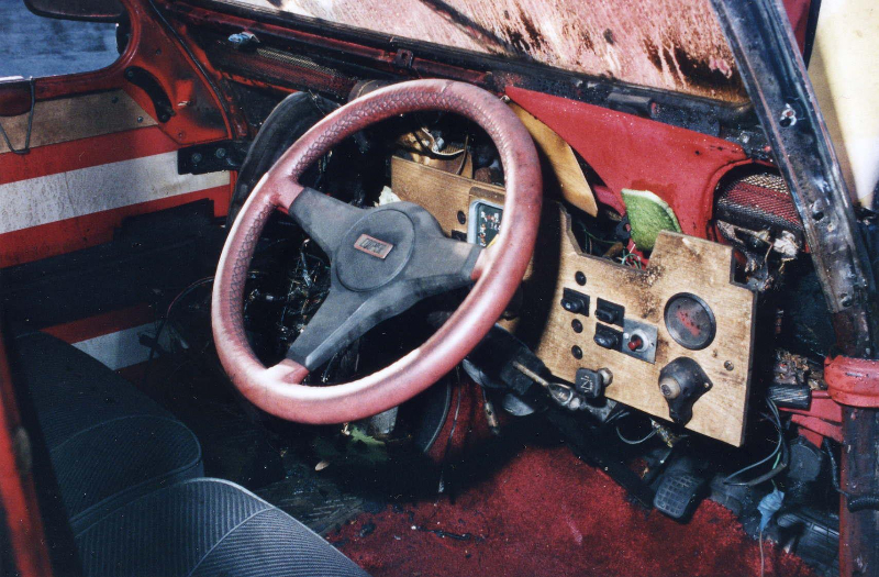

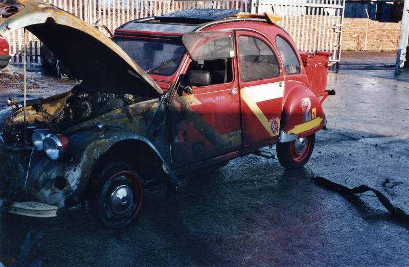

Old2cvman... stopping by'e with another Historic memory...... I built this Red Devil, in the early 1980s... from a scrapper I bought cheap.....another vehicle to my abundance fleet, of 2 C.V. variants that a used at weekend events, I ran this for approx five years.... before she sadly died. in a quick Cremation Ceremony.
I was driving home from work one evening, and the Petrol delivery pipe up to the Carburetor, slipped of its mounting and pumped fuel onto a red hot manifold, the underside of my Bonnet was lined with 2 inch thick noise eliminating Wadding, which caught fire instantly... in 6 seconds of braking and jumping out the Car to save my Life... she was gone.... before you ask..... Oh Yes I had a Commercial Heavy duty extinguisher under the passenger seat... it was a senario of Run for your Life.

The solution is call "serflex"old2cvman a écrit :the Petrol delivery pipe up to the Carburetor, slipped of its mounting .

The lesson is ?
Always buy an extinguisher ? Ask your passenger to watch after de fuel pipe ?
Not of all, today's lesson is : fuel pipe end must be strongly tight Serflex or Colson band.
Anyway, she was saved and you too

Ouch ! Poor car ! You save your life, it the most important ... (The AUDI in the back seems to have had the same story as yours
