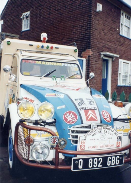

Hello all readers.... Old2cvman... is back again... I am bewildered at the response, that my original Story generated..... Hence my photographic catalogue of events... which I felt would illustrate my predicament and how I rectified my sustained underside vehicular damage.
Some one thinks I dreamed up this situation, which is a ridiculous assumption, when reading response posts.... even at the ripe old age of just 86, I am still anxious to learn about Citroen 2 C.V. vehicles.
I bought my first 2.C.V. at Easter Holidays 1955.... see my attached picture.... over the period I ran this little Camionette, I extensively modified its appearance ... and travelled to Monte Carlo in it several times from Liverpool. England a distance of 1362 miles... in this it was a 40 hours drive none stop.... apart from 2 hours crossing the channel Dover to Calais.
As my married life progressed.. my taste in vehicles had to change to a family Car.. but I still had a Love affair with 2 C.V.s
I bought a couple of scrappers .. and set about making, my own personnel 2.C.V. carravanette ... see my attached photographs..... which I subsequently used for my Monte Carlo adventures later in Life... as well as being a Juggernaut Jockey for 50 years World wide.... so readers I am not just some Old Dam fool writing dribble stories ... every thing I present is accurate.
